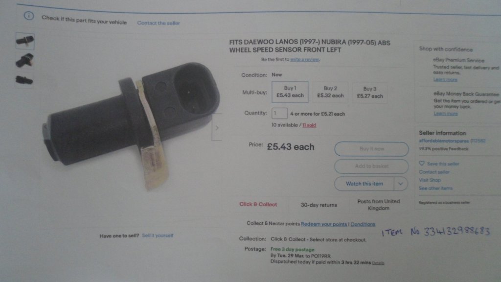

ABS alternative sensor. first assemble you're parts 1, Daewoo Lanos (1997-) Nubria (1997-05) ABS wheel sensor left or right not important as you will be cutting off the metal bracket . E-Bay item 334132988683 price £5.43.download/file.php?mode=view&id=881

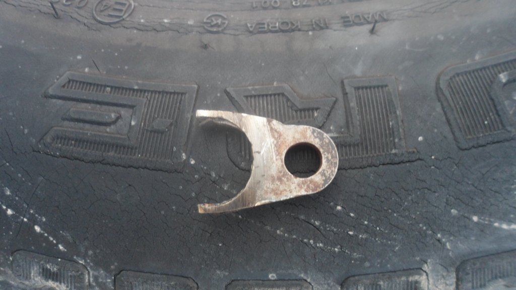

Remove you're original sensor be careful not to shear off the retaining bolt , cut the wire to the original sensor close to the sensor ,the sensor will be destroyed during removal from the original sensor you will need to retain the metal bracket as this will attach the new sensor . cut the old bracket across the large hole replicating the bracket you cut off the daewoo sensor.Image put a 1.5mm washer onto the daewoo sensor and fit into original location useing the original cut down bracket you may have to clean the sensor location hole with a file or sandpaper . fit the socket end of the connector to the original wiring solder and heat shrink and you are done.Image

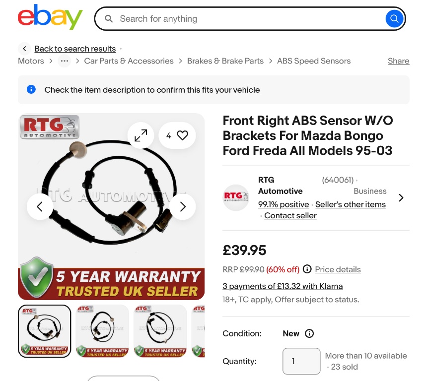

Post by Bongolian » Mon Jul 28, 2025 2:29 pm
These are significantly cheaper and come with all brackets required..

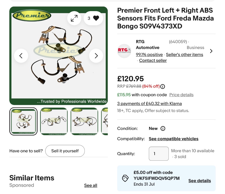

Re: Abs sensor alternative
Post by Bongolian » Mon Jul 28, 2025 2:33 pm
Alternatively, without brackets but with no need to mess with any wiring, these look suitable too.

Post by Bongolian » Fri Aug 01, 2025 2:30 pm
Found and fitted these in the the end for my ‘98 diesel..
https://www.ebay.co.uk/itm/326424644295 ... Sw9vBlWIJn
I messaged the seller who asked for my reg number and advised on the correct parts, handily the even included a link to the item.
They fitted perfectly, and after applying the discount shown, were £88 for the pair, complete with brackets and have a 5-year warranty.
Not as cheap as the Daewoo ones suggested previously, but far less pfaff than cutting wires on alternative parts to suit imo.
