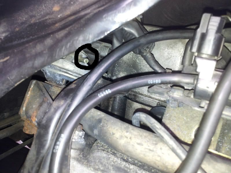

Right, i have taken some photos and i have found two stubs that the two floating tubes appear they should be connected too.
From the previous links to wiki i can't figure out what goes where. Don't know if i am just being stupid but it doesn't appear to be the same as mine.
Broken stub as per Northern Bongolow's post, http://www.igmaynard.co.uk/bongo/forum/ ... =3&t=50170
Pipe with valve check goes here, confirmed from pic in intake thread
And the other stub;

Post by jaylee » Sun Apr 15, 2012 3:59 pm
Where you circled in black the loose pipe goes...!

Post by stefan442 » Sun Apr 15, 2012 4:05 pm
jaylee wrote:Where you circled in black the loose pipe goes...!
http://i56.photobucket.com/albums/g179/ ... 0458-1.jpg
Im all over it, will probably need some new pipe.
Thanks, you been a big help!
