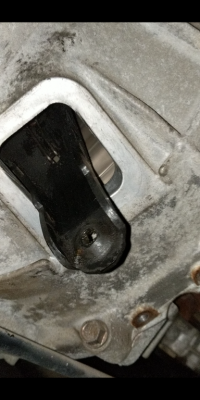

Thanks Rita. Is the withdrawal lever you mention behind this square rubber gasket that the clutch slave cylinder attached to?
Re: Manual Gearbox Query
Posted: Tue Nov 17, 2020 10:38 am
by rita
BongoNC wrote: Tue Nov 17, 2020 5:28 am
Yes thats thats the lever.

@rita I got under my Bongolow tonight and removed the
clutch slave cylinder and the rubber boot covering the
clutch lever in the bell housing case. I couldn't tell is anything is out of sorts but i made a quick video showing the action of the lever with nothing attached to it.
https://photos.app.goo.gl/hHgrTvS6YzUNH19y7
Hope that link works.
The picture below here just shows the lever with the boot off.
- Slave cylinder and rubber boot removed
