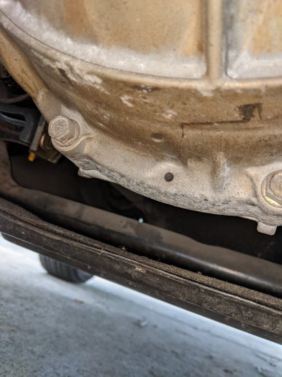

Hello again. I crawled under my Bongolow today and had a look at the bottom of the bell housing. Every surface around the hole at the bottom are bone dry. I can't find evidence of any trans oil coming out of bell housing nor the transmission itself. Attaching a photo of the rear side of bell housing. Sigh. Maybe this is leaning toward just a bad clutch? At only 14km total miles.

rita
Posts: 3286
Re: Manual Gearbox Query
Post by rita » Mon Nov 16, 2020 11:30 am
It would be worth checking that the withdrawal lever has clearance and not sticking.
Another way to check the strength of the clutch assay is to drive the vehicle at a fair speed keeping your foot on the accelerator , quickly dip the clutch and release. If the clutch is faulty you will know.

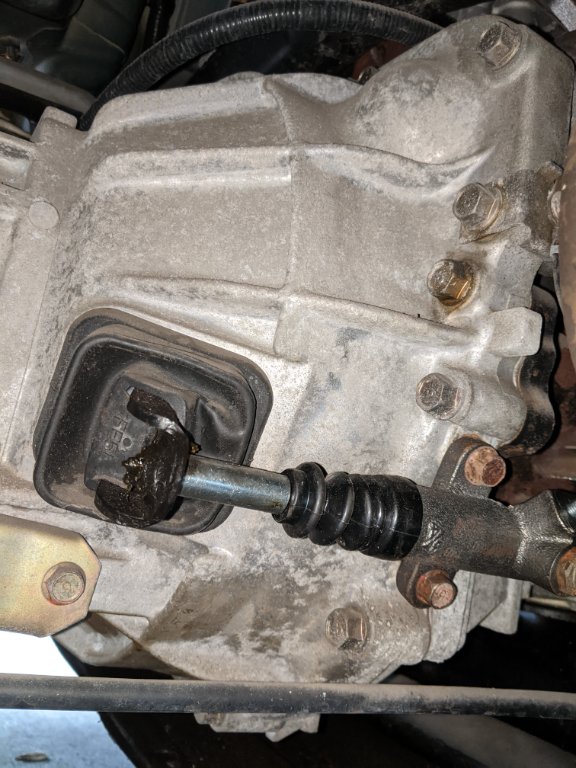

Thanks Rita. Is the withdrawal lever you mention behind this square rubber gasket that the clutch slave cylinder attached to?

Post by rita » Tue Nov 17, 2020 10:38 am
BongoNC wrote: Tue Nov 17, 2020 5:28 am Thanks Rita. Is the withdrawal lever you mention behind this square rubber gasket that the clutch slave cylinder attached to?
Yes thats thats the lever.

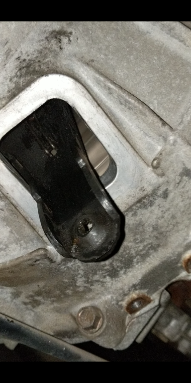

Post by BongoNC » Wed Nov 25, 2020 3:39 am
@rita I got under my Bongolow tonight and removed the clutch slave cylinder and the rubber boot covering the clutch lever in the bell housing case. I couldn't tell is anything is out of sorts but i made a quick video showing the action of the lever with nothing attached to it.

The picture below here just shows the lever with the boot off.
Slave cylinder and rubber boot removed
