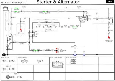

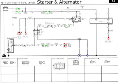

Welcome aboard!
Which engine do you have ?
There are variations here are both;

Re: No Start, No Crank, No click
Cheers for the drawing, that'll give me something to start checking. I'm an Electrical Engineer by trade so hopefully should only blow some fuses once.
Gaz
Gaz
