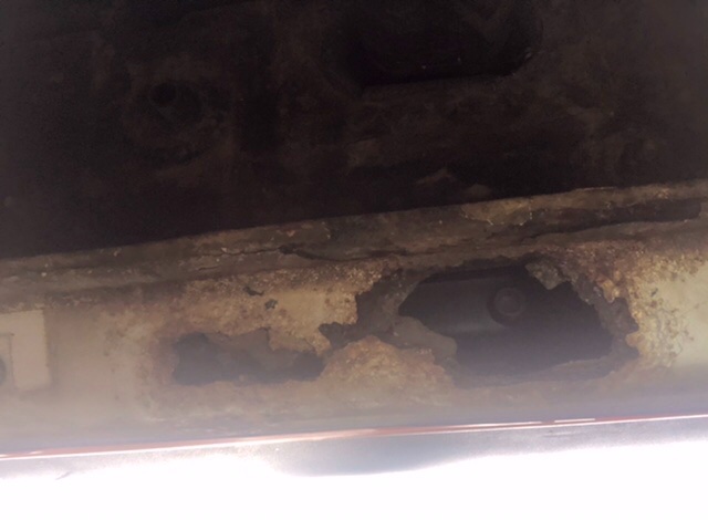

Post by LordBongoOfBanbury » Fri Jul 28, 2023 10:41 pm
Hello all,
New here, please be kind!
Although I've been a long time Bongo admirer, I only yesterday joined the ownership club, picking up a nice 2002 2.5l V6 example from Winchester.
Inevitably, it has some rust issues despite being undersealed by JAL when it was imported in 2011.
The most recent MOT (October 2022) gave an advisory of rust on the offside front section of the chassis (pictured). Does anyone have any experience with this particular corrosion issue, have any suggestions as to the repair costs and where the best place near to Banbury is to take it to have the work done?
Cheers! Matt. Image

Post by Ian » Sat Jul 29, 2023 7:57 am
We don't have any Bongo specific rust experts in your area I'm afraid. But you could always try the national Rustmaster chain (who are very good) or contact a local car restoration society as they will do this kind of stuff all the time.
