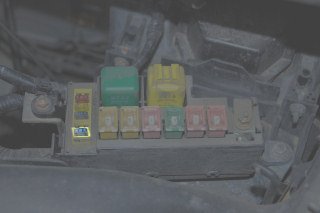

The original wiring means that the Fog lights can only be used when the sidelights are on, however lots of people have added there own fog lights and add there own wiring rather than using the existing loom and switches. The Fuse for the standard fog lights is the 15 Amp in the fuse block under the bonnet

Fuses good
