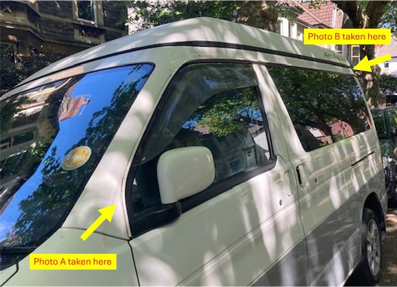

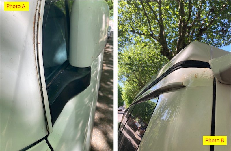

Advice here states we'll need to first attach Fig 8 to the van Gutter Rails - are these rails the small channels found on the side of van, as per photo's below?
They seem so shallow - how does a Fig 8 stay on securely?? And how do we actually attach it - does it slide or clip on easily?

The fig-of-8 slides on and is normally quite hard to fit the first time as it grips rather well! Many just leave it on permanently especially the long ones!
Some people fit it by putting it to the edge above and then pull it down horizontally causing the outer edge to slide over and underneath.
You can fit shorter lengths but people have reported water leaks when its raining over the door at the joins!

Thanks Geoff - and are the rails the small channel things on the side?

No need to pay that much: https://olproshop.com/figure-of-8-plast ... pack-of-3/
And yes, they fit on the gutters as indicated in your photo

Yes the "rails" are the rain gutters.
