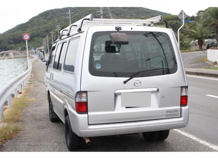

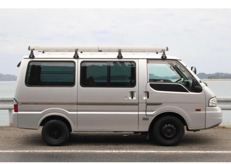

The photos show 4 rear wheels, six wheels total. I’m assuming it’s 4WD because the company acquiring it is only vetting 4WD options. It’s listed as 4WD in the auction.

If it has 6 wheels total with 4 wheels on the rear axle then its totally non-standard, not an option from the factory! I'm sure our old Russian friends would have loved a 4-wheel rear axle version given there climate and use of the Bongo!
Do you have a photo showing the 4 wheels on a rear axle ?
In Bongo parlance 4WD means 4-wheel drive i.e. both rear wheels and both front wheels a total of 4 wheels.

Post by eyemgh » Fri Nov 01, 2024 6:00 pm
g8dhe wrote: Fri Nov 01, 2024 5:43 pm
Posts: 10889
Re: Four Wheel Rear Axle
Post by g8dhe » Fri Nov 01, 2024 6:08 pm
Ah not a Mazda Bongo Friendee (Ford Freda) which is what this forum mainly covers, looks like something based on the Fourth-generation Mazda Bongo Van DX (SLP2V) with dual sliding door crossed with one of the vans Second generation Mazda Bongo or maybe the E2000 range non of which are the Friendee model. Take a look at the Wikipedia page for the various models and details https://en.wikipedia.org/wiki/Mazda_Bongo
