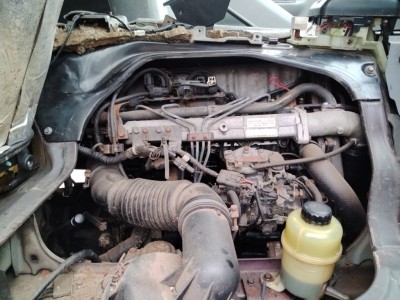

Can anyone give me some advice on general engine cleaning, oiling, greasing and saving the mechanical bits and pieces. Here is a picture of the engine bay under the drivers seat. Ignoring the low power steering fluid - as you can see everything is generally rusty and dirty. What would someone who knows what they are doing, do here? I am not a mechanic and everything I touch tends to get worse so I want to be careful. Suggestions please?

I wouldn't be too bothered about cleaning in there but WD40 sprayed around and given a wipe will do the job if you're concerned, it will also keep the damp at bay.
When I get a vehicle second hand I tend to go over all the electrical connectors I come across, unplug them and look for green corrosion on the terminals, if they are discoloured I'll spray the WD 40 in them then plug and unplug a few times till the green crap is gone and then reassemble after putting a dab of vaseline on those terminals, also check any earth wires you come across for corrosion/breakages too, replace any which are damaged but usually only the terminals will need a bit of a rub with emery paper to clean those up then do the same with the dab of vaseline before re-connecting.
The appearance of the engine isn't going to create problems and neither is surface rust on bolts/parts etc, you could be anal about it and spend hours trying to clean it all up but its unnecessary, Power steering fluid by the way isn't black so I'd be having that changed or diy in my case, it also doesn't tend to disappear so you'll need to follow the pipework and see if its leaking somewhere. I had the same problem on an old Lexus I had, it didn't affect the steering as like yours there was still sufficient in the system and my leak was easy as the pipework ran in front of the radiator behind the grill and was in a rusted bend in the metal pipe, I simply hacksawed the rusty part off and rejoined it with rubber fuel pipe, it lasted the rest of the cars life. H
