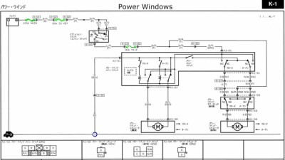

Hi Bob, depends whats failed there are several circuits, door lock uses three, windows use 4, mirrors plus +12v and earth. Quite often more than one wire will break at a time;
I haven't got a copy of the Mirrors wiring with me and my router failed as I was leaving for the Bash so nine of my web pages are alive at the moment :-(
