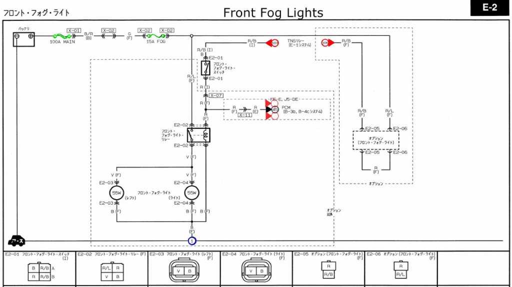

Hi guys hope you all well, broke my fog light switch on 1996 Bongo does anyone know what the spare green wire is for behind the switch please
Thank you in advance :?:

There isn't a Green wire associated with the Front Fog lights ?
Any rear fog light is a local add-on in the UK as there not required in Japan.
