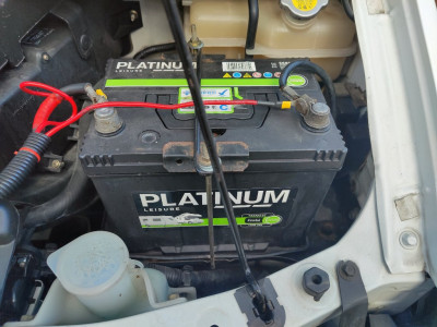

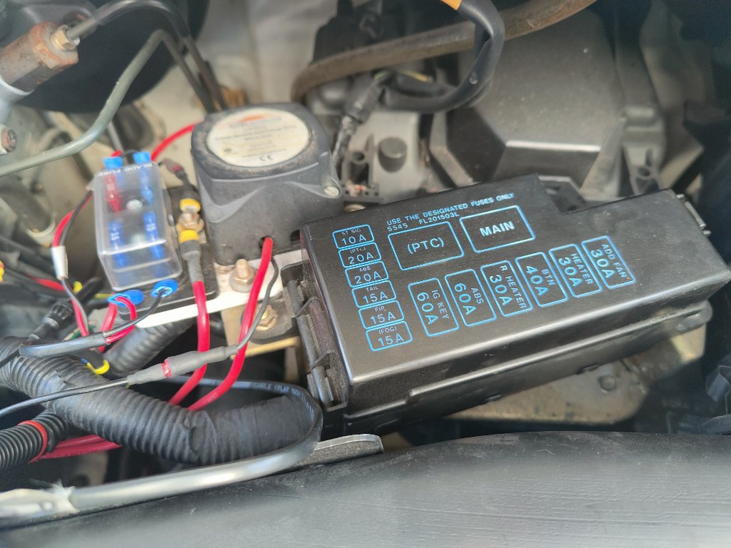

What I found under the bonnet was that I have two batteries with an Altec voltage sensing charge relay between them, and a small fuseboard beside the relay which patches into the original cabin fuseboard to cover lights, sockets, radio and blinds. The charge relay wiring was incorrect with a red cable connected to the -ve terminal of the leisure battery instead of +ve. In fact, on further inspection the +ve sensing fuse was removed so the voltage sensing charge relay is doing diddly squat.
More notable was the 'fat' red cable to the +ve terminal of the leisure battery, which I now know is a parallel circuit for the Cold Start option (I also have the engine switch, which confirms it). This is why he said the leisure battery helped start the car and why there's no separation of circuits between batteries despite the second fuseboard and patching.

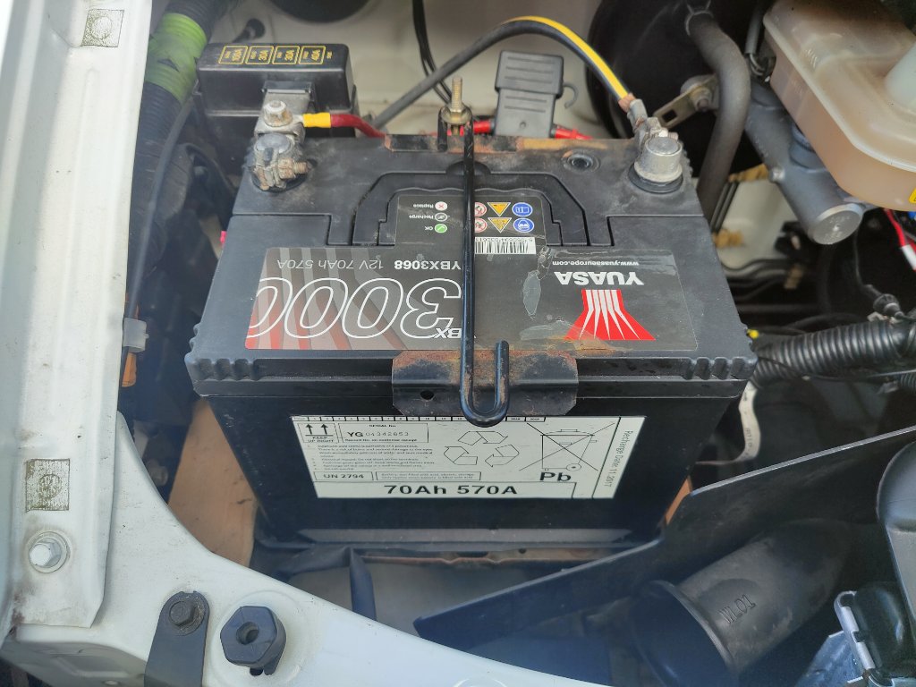

I’m no expert with the electrical wizardry however in your photos it appears you have a 70amp as the starter battery. I think that’s too small for a 2.5D. I’m not sure why there is a red cable going to the negative on the leisure battery? Maybe previous owner didn’t have any black left but doesn’t look right. Plus, it appears to be routed directly over the leisure positive terminal and looks like it could easily short.

I haven't taken the cables out of the kopex but there is one 6mm red sensing cable going to the starter battery +ve and a 6mm red charging cable going to the leisure battery +ve. The 6mm red cable going over the top of the leisure battery is the fuseboard output (I think) which should also go to the +ve. It's deliberately marked with black heatshrink. Every wiring diagram I've seen for a voltage sensing charge relay circuit has two cables from the leisure battery +ve and only ground to the -ve. All of that wiring is wrong to me.

(Oh and these photos show the wooden spacer blocks around the starter battery and missing tie down bolt from the battery clamp. Pretty sure that's an MOT fail. I've fixed that already.)

Good job on the starter battery clamp I’d not noticed that. I’d also suggest getting some battery terminal covers. In a worst case scenario it’s possible the bonnet could make contact and arc across the un protected terminal posts.
