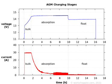

Normally there is a menu of battery types you select the right battery type from it. There isn't a single parameter as it depends on time/current/temperature, basically once the battery is classed as full then the charging voltage is dropped to the float voltage. Be aware however that if you also have a Split Charge Setup then all the benefits will be lost as the alternator doesn't know about AGM batteries and simply keeps blasting it with 14.4v (approx) all the time your driving!

Just choose "Deep Cycle Sealed" for the battery type and that is all that should be necessary, it will (according to the manual) adjust the parameters itself over a few charge/discharge cycles.
