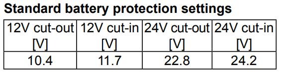

Will those 12v fridges run until they drain the leisure battery, or do they usually include some sort of intelligent shut down to protect it? ie switch off when leisure battery down to 50%?

Yes the fridges have a cut-off voltage that preserves the battery, if you look at the right spec sheets its even configurable if you wish;

Thanks Geoff. I'd never have guessed it was possible to connect my fridge to a laptop by usb!
What's a sensible cut off to avoid damaging a leisure battery (standard lead, not lithium)?

I would leave it at the default settings unless you have special reasons to change it.
