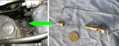

This is the Banjo filter and location;
On some it has been removed, which isn't always the best idea, its the final very fine filter before the engine itself, be careful getting it out and then wash out with fuel etc.Geoff

Re: Diesel filter problems
Thanks very much, I shall have a look tomorrow.

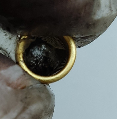

I'd second the banjo filter. Mine blocked up after changing the fuel filter so it was restricting the flow.
Easy to remove to check, this was mine. I'd had no problems before changing the filter so it must have disturbed bits...

Hi thank you for your info. It was the banjo filter that was full of muck, cleaned it out and it started first time and runs great now. Cheers all.
