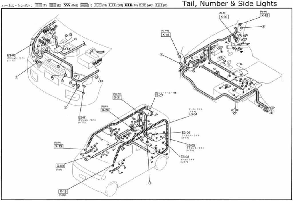

So the tail light 15amp fuse keeps blowing on our 2000 reg Friendee Auto 2.5 petrol V6 with LPG conversion. As well as the tail lights going, the dash illumination also goes, as does the centre console cupholder light. The Hold button seems to have failed too, but that could be coincidence. Jacob at Bongo Mad has had it in a couple of times and can't work it out. An auto-electrician has also spent a day on it - it's not a fault with anything at the back, or the tow bar, or water in the light fitting, or the switch at the steering wheel, or the window adjusters, or the radio, or the fog light, or the air-con, or the leisure battery. Apparently the tail light circuit seems to be drawing about 24amps, and a 25amp fuse holds, but obviously can't be used in place of a 15amp fuse as any kind of fix. There's a short somewhere - probably a wire chafing and/or touching the chassis. We are not remotely savvy on any of this, and need to find someone who can go through the wiring to find the short/ fault. It's got to the point where we'd happily leave it with someone for as long as it took for it to get sorted as at the moment we can't use it as soon as it starts to get dark. We're in Hastings but at this point I'd drive pretty far to someone who can help us. Any thoughts/ reccommendations?

Check the wiring loom that goes from body to tailgate, it snaps/ shorts.

If you take the back door inner panel off you can test through the wiring to the number plate lights etc.
The number plate lights are known to rot at the back of the bulb holders, then you could check for one or more broken wires inside the rubber grommet that goes from the roof body to the door, these fracture and short out sometimes intermittently causing your level of frustation

Yes that circuit is a right pain! It covers everything coupled with the sidelights, dashlights, locating lights etc. The wiring loom runs around a good part of the van and its difficult to separate that main loom connectors to try and isolate it to a given section.
