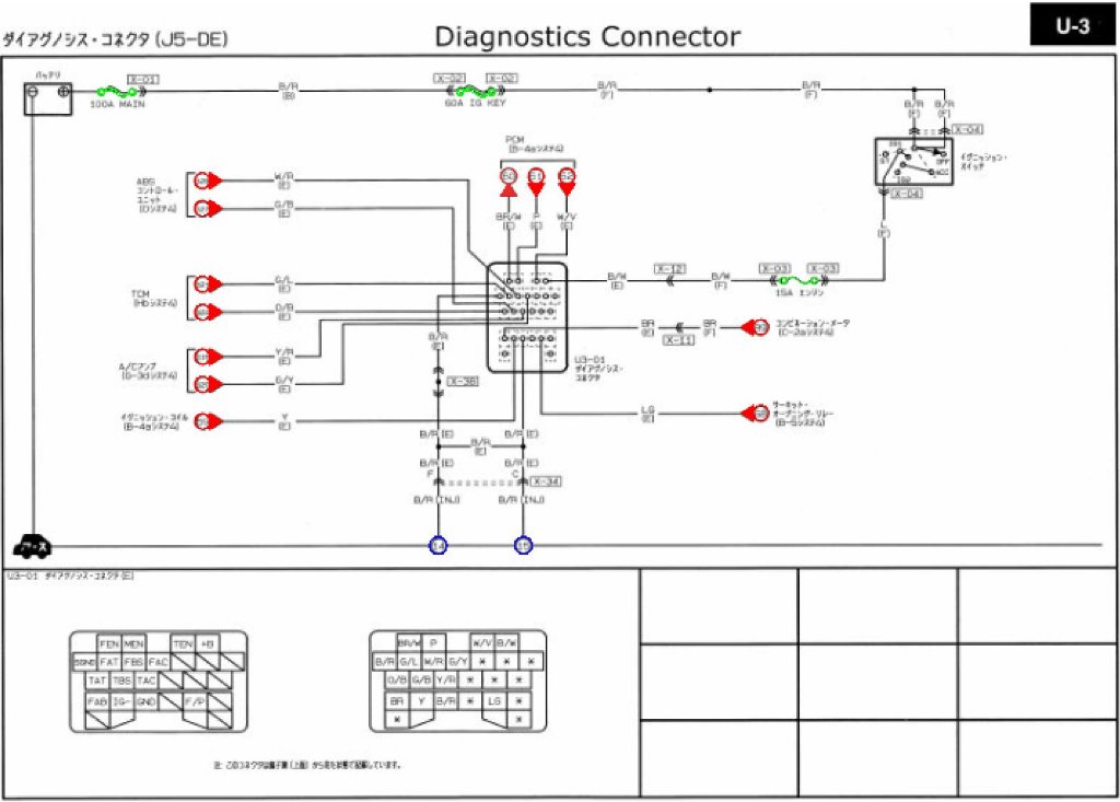

Are you sure your selecting the right pins, the box is mounted upside down compared to the other vehicles which is where the diagrams come from. The error code flashes won't start until you put the links in place, prior to that its just the on/off flash.
http://www.philmcfadden.co.uk/MazdaDiagnosticBox.htm
The fuse is the far left 15Amp Blue middle row, which also supplies lots of other circuits around the engine itself.

The wiring goes back to the relevant computer, PCM, TCM, ABS etc.
Make sure you do have the diagram correctly oriented, its upside down in the Bongo. also make sure your linking the correct pins its an automatic not a Manual gearbox for most people!

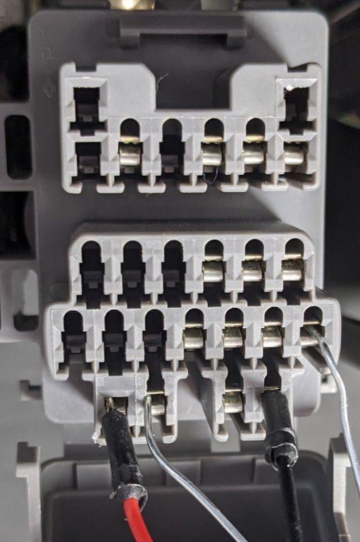

Here's my configuration for connections
Posts: 10766
Re: Hold flashing and error with diagnostic port
Post by g8dhe » Fri Sep 03, 2021 4:47 pm
Try using the TAT and FAT pins respectively (rather than TEN and FEN) as your probably an automatic gear box ?

Post by Bongold » Fri Sep 03, 2021 4:58 pm
Yes, it's an auto.
I thought the TEN and FEN were for engine codes and TAT and FAT were for auto box codes?
Anyway, no lights with either configuration.
