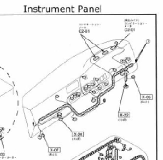

Could be an earthing problem for the dashboard display, take a look at earthing point 7 righthand end of dashboard;
