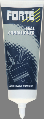

2. If it IS the cam seals, how long would (forget the name of the seal renew stuff Geoff used) last before I had to bite the bullet?

The sealant additive;
Lasted quite some time, the cam belt had been changed on import and then we noticed the oil smell around Feb 2012 I used a couple of doses over the next year until it was changed again in Feb 2013. So one tube's worth should last 6 months or so, but might depend on how bad the leak is of course!
