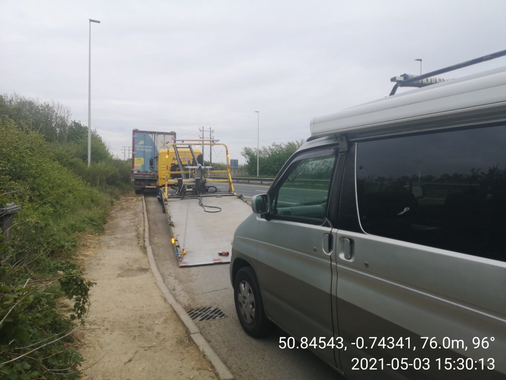

Well looks like my summer plans are to be disrupted - heading back from Poole yesterday without warning the engine (V6) seized :cry:

There really wasn't any symptoms, had been driving for 1 1/2 hours at the limit along A31/New Forest/M27/A27 went around a roundabout came back up to speed on the A27 we all sorted ourselves out started to put my foot down and ..... nothing .... couple of seconds confusion, no lights, no noises, no smoke, no vibration, so managed to pull across to the nearside when a lay-by appeared so made use of it, by which time brakes and steering getting heavy. After stopping and drawing breathe, the starter was making great efforts but just couldn't turn the engine over at all.
