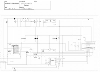

Post by g8dhe » Thu Mar 04, 2021 5:57 pm
You do realise that its a small 8-bit microcomputer controlling it ?
What exactly is the problem your having ?
