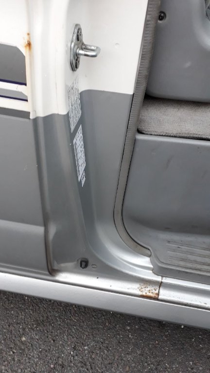

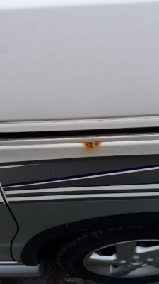

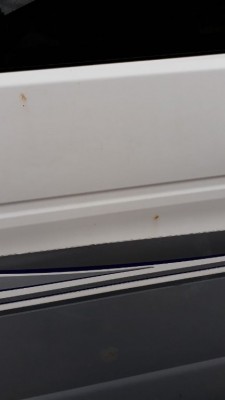

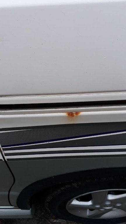

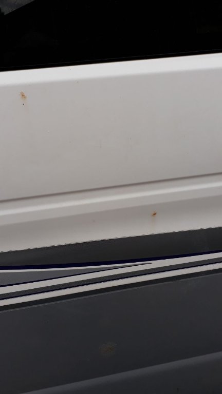

These are the worst spots. There are a few much smaller ones too.

Thank you Roy 748 I take note. I've made a start but weather has now defeated me.
