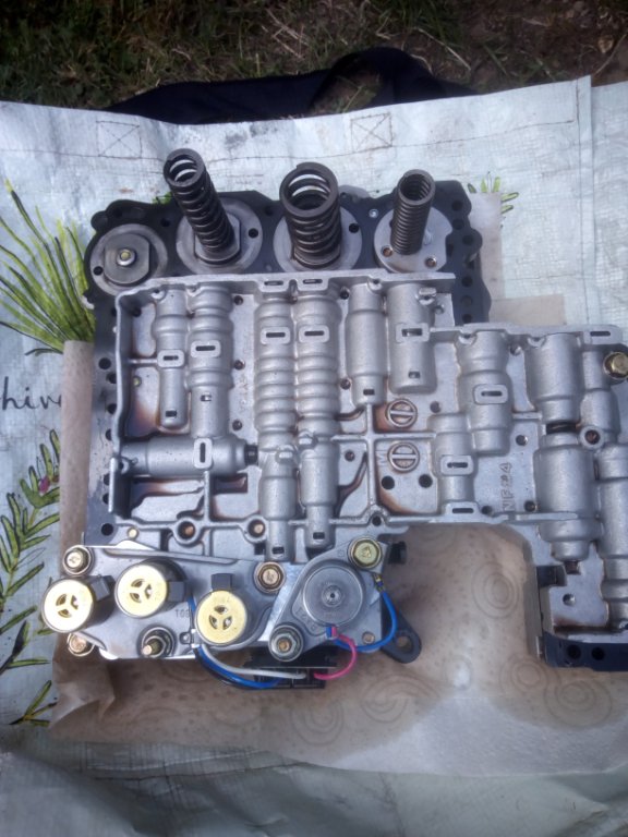

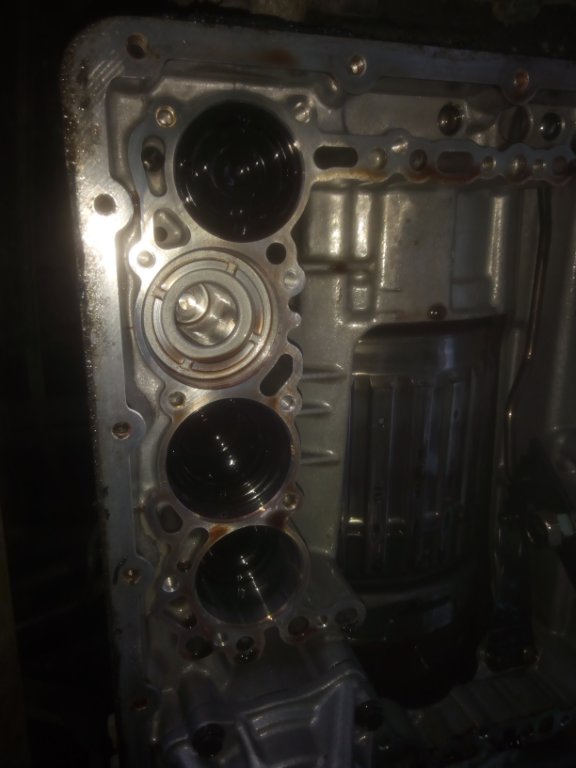

				Done 2 stupid things!
1. In lowering the valve body (replacing solenoid pack) I failed to note (late in the day and lowering from the drivers side) the order of the accumulator springs. One largest and fatter than the other 2 which are of a similar length but one slightly larger diameter. I am assuming! that the largest at front and the other 2 in size order (larger smaller) at the rear. However, there are 4 accumulator "ports" from front to back and number 3 does not appear to have anything in it. So, 3 springs, 4 ports. Has anybody any idea/experience of the this?
PS nothing "sprang" out or fell off during lowering.....these are the parts/springs which I have.
2. Embarked on this in the first place.
I will mark and photograph the valve body bolts which are removed in this process for anybody brave enough to embark on this fairly straight forward job. Help with the spring locations would be perfect for a complete set of instructions.
Thanks in advance.
