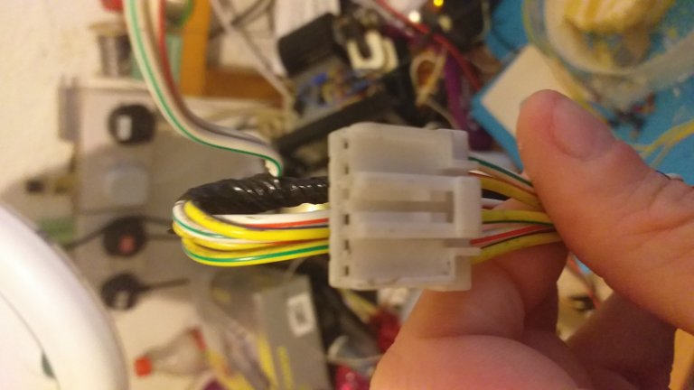

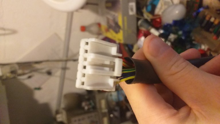

Is it possible to have a picture of the original connector? I may possibly have them here, all the blind wiring was taken from the loom as there is no electric blinds in mine.

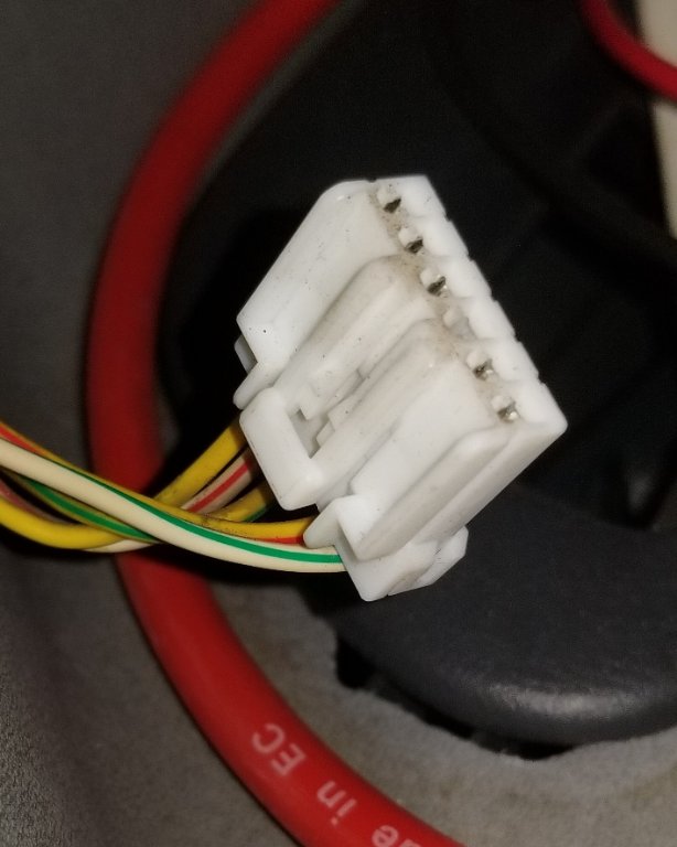

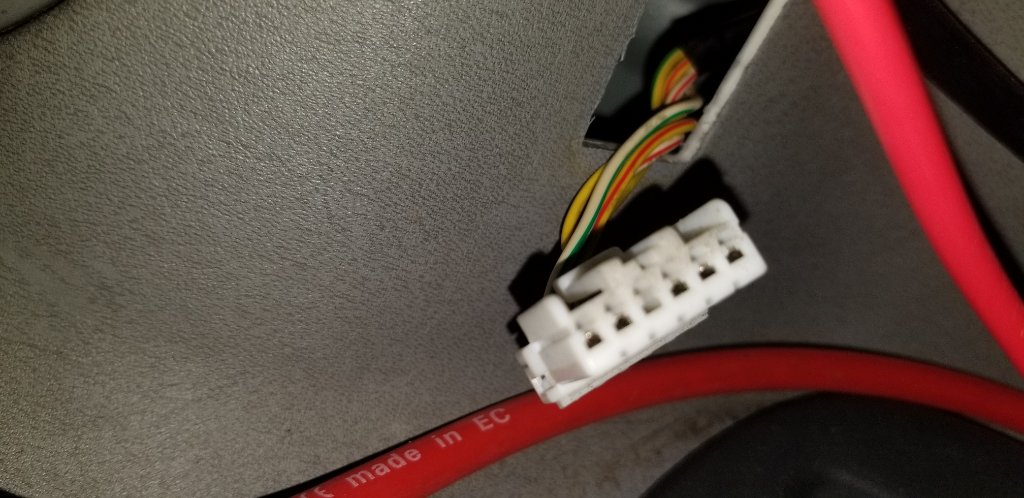

Problem with going off the socket like that is your gonna need a plug when you get to the switch.
There should be enough slack to allow you to snip the plug off and extend. Is the van insulated,could that be stopping you getting the slack?
In the image I posted re speakers you can see the slack you should have.
Incidently if you look at the dangling red wire in that image behind it is a white block with black tape around it. That is a spare window switch plug unpopulated. No idea why they taped it in but FYI.

The wire I'm looking at appears to be the whiter pale window switch wire in your photo. It doesn't show well in the photo but the wire is part of a loom that seems to either come from the rear, or go to the rear. That bit of the loom is stopping the switch wire from moving.
In reality I'm doing all this whilst jammed in a cupboard behind the kitchen. I would try to cut the loom sheath with a knife but the cha ces are I'll cut a wire.
The spare switch feed seemed ideal, if for now other reason than it gives me a plug to cut off and reuse, however I can't see it here so it must be hidden behind the panel to the rear somewhere.

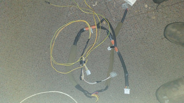

Just found them, the wires are approx 2 foot long, there are five of them, if these cound be spliced in, then it may solve the problem.
I have a box of scrap stuff awaiting disposal, if anyone can make use of it.

Correction, 1 is a fit long, the other looks to be about 2 foot.
These are pretty much as seen in the below pic, please excuse the white wash, the phone insisted on using the flash.
