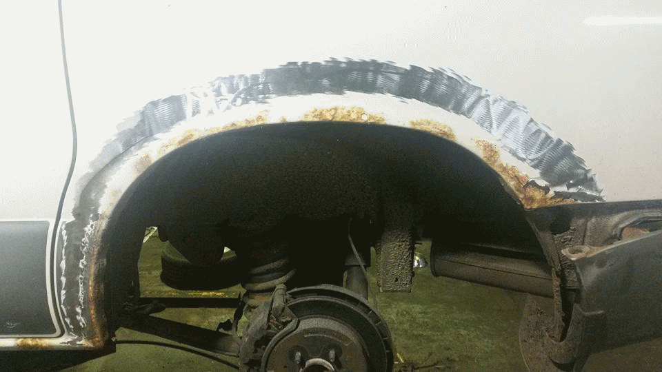

Just dealing with the dreaded rear wheel arches on my 95 Freda, Can anyone give me advice on where's the best place to purchase rear wheel arch repair panels?

I bought a set off eBay, seem pretty good

See this set of images here click the image for the full details, Paul Horsfall put them together (he has done a few ;-) - works at Discount Trucks);

They look the same as the panels I bought. I will let you how I get on in a few weeks. Used to welding up old Hondas, which are paper thin, so I'll manage.

I recall being told that the arches need an insert section welding in at their apex if they are to match the circumference of the original (and thus match up to / line up with the bumper). No doubt you're onto that but i mention it in case.

This is an animation showing the alignment - the wheel hub is used as reference and the two images show the before and fitted positions;

mikeonb4c wrote: Thu Mar 22, 2018 11:08 am I recall being told that the arches need an insert section welding in at their apex if they are to match the circumference of the original (and thus match up to / line up with the bumper). No doubt you're onto that but i mention it in case.
If you use the Merc arches it is advisable to do as you say,cut and weld in a fillet .

Heres a link to how I did mine using merc arches. If you want to keep the right arch shape and keep the thickness of the dog leg at the sliding door right you need to put the insert about a third of the way up on the left portion of the arch.
I also let the panel in up behind the original quarter panel, its easier to level that way and the repair can be much tighter.

So have I got this right? you can use merc wheel arches instead of mazda arches? If so what merc arches can I use ?

THIS LINK has info on Mercedes arches
