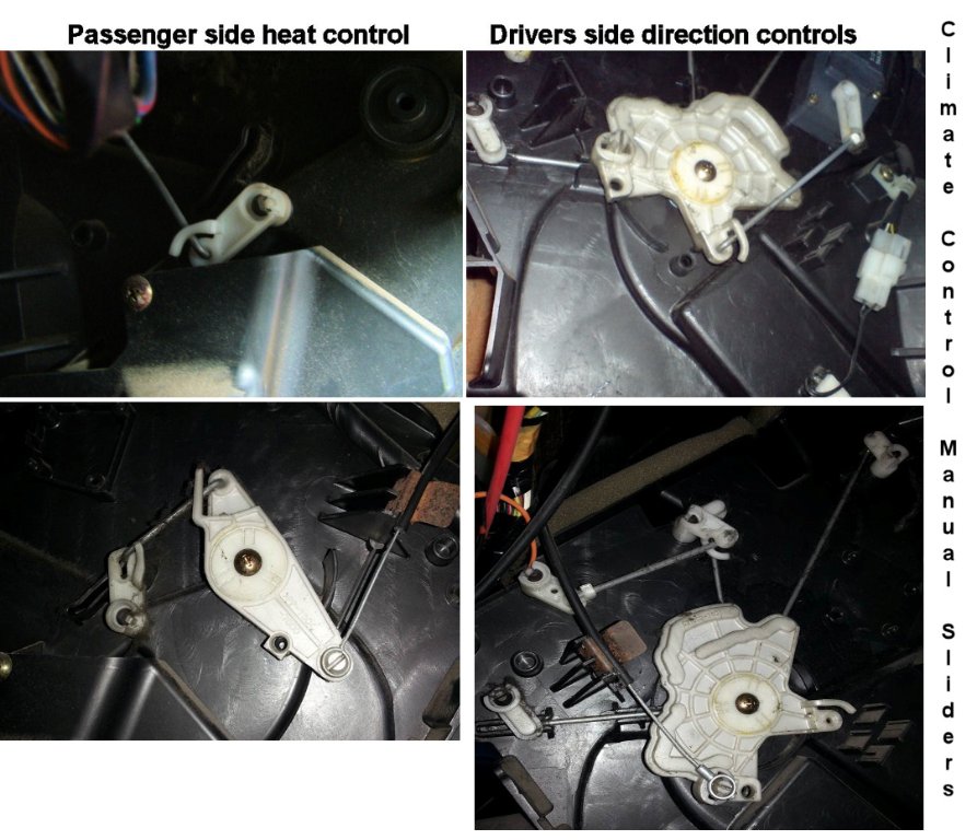

I have the sliding manual controls but think i may of damaged a cable as the vent selector is no longer working.
How do I get behind there to have a look? Do i have to take the whole dash off?
Steve
Posts: 10750
Re: Manual Heater Controls
Post by g8dhe » Tue Feb 16, 2021 4:25 pm
No but they are a bit fiddly, the unit removes like a radio does, remove left & right trim sections and then insert release tool, but you also have to reach behind and disconnect the bowden cables see here http://www.lushprojects.com/bongopartsm ... 1of02.html
Posts: 15389
Post by Bob » Tue Feb 16, 2021 4:43 pm
Have a look down in the footwell.
The cables are prone to coming off the plastic thingy there. :wink:

Perfect
Thanks all.
Fortunately its stuck on the screen vent.
