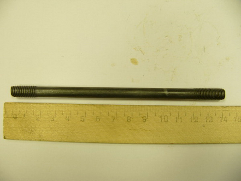

7 ltrs and you want Dexron 3 or higher - full volume ATF you need - apr 15ltrs!!! for change all - you need remove sump AT and blow air in cooler and clean oil sistem washing new ATF
NOTE: that bolt dont contact antifrieze!!! it twisted into front cover - "gear place"....I used tap num1 Image and more long bolt - from motorcycles head Image
