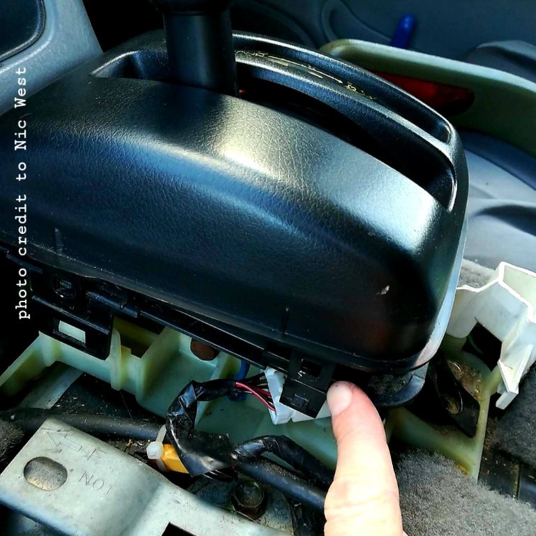

These are the 3 ways I've seen described, for changing the gear selector strip:
1. "Take out the center console and undo the 2 screw in the front side of the selector. Then you can lift it, but don't have to remove it completely. There's a button and a spring, they may try to escape. There are 4 metal push-in clips (on the side, see photo). They hold the selector strip cover on. Push them with a flat-blade screwdriver to release them. Lift the cover you can see the strip underneath."
2. "Remove the centre console, unclip the gear surrounding, and turn it 90 degrees. You can slide out the old strip and slide in the new one. It can be fiddly to slide it under the clips. The strip slides into locating grooves.
3. "The gearknob is held on by screws. Undo them. Theres a plastic cover over the selector strip. Lift it so you can get underneath, to remove the old strip. It often breaks into pieces; get them all out. The strip fits into locator grooves. Slide the new one in to these, from front to back.
(Updated to make instructions clearer.)
