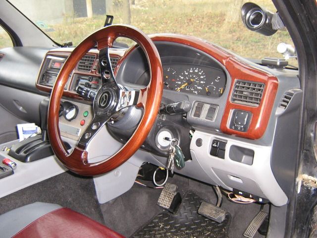

That's excellent to hear. The other thing I have heard concerns about is clearance over the control stalks so your hands don't bash them while steering.
How dished is your wheel Helen? Would you be able to post a pic so I can get an idea of how it looks once change please?
Thanks Mike
Thanks Mike

Re: Confused about steering wheels
Mine's fairly flat because I fitted a quick-release steering wheel boss on top of the other one. I'll post pictures later
Helen
Here you go, a picture of the wheel:
It's had quite a few modifications to the interior and exterior since that pic!....oh, and the steering wheel was a limited edition re-issue of a particular classic...superb wheel!
Helen
That looks great! I have been toying with the idea of a wooden wheel as I think they look ace. I like your wooden look dash surround as well.
