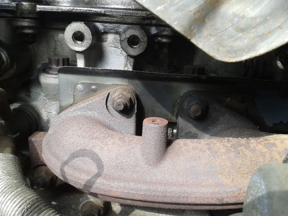

It does sound a bit exhausty which would be consistent with no.1 manifold stud being loose or broken. Have a look at the exhaust manifold where it meets the head and you'll probably find it's black with soot at the front of the engine where no.1 stud is. Is it DIY-able? I'd say on balance no if the stud has snapped in or close to the head. You may be lucky and just find the nut has come loose. Is it ok to drive? Yes, for short term but if the manifold continues to warp (which is why the studs snap) it will increase the chances of problems with the new stud and possibly even the manifold cracking when tightened under tension.

Ok, so I have had a look and I don't think it's the bolt. Here is a pic with the heat shield lifted up:
I got a socket in to give the bolt a little tweak just to see if it was loose and it didn't appear to be. However I didn't give it much force as I didn't want to cause it to shear.
So I started it up again and put my ear right by the alternator (luckily I don't have much hair so no danger of getting it trapped!) and had a good listen and I reckon that's where the noise is coming from. I have to say there is never a problem with the battery, it's always very positive starting.
The belt feels nice and tight so I don't think need tensioning (but I could be wrong of course). Could it be that I need a new couple of belts or perhaps a new alternator?
