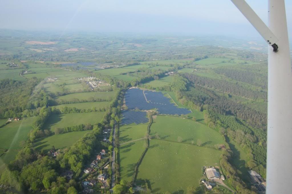

... p.s. if you thought 100Watts was a lot. I went out in my mate's microlight yesterday and saw this...
