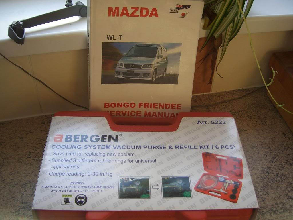

How about a mobile muchanic .. ??
Just be 110% sure they know how to 'manually' bleed a Bongo .. or have a compressor and a vacuum bleed system suitable for mid engined cars ..
