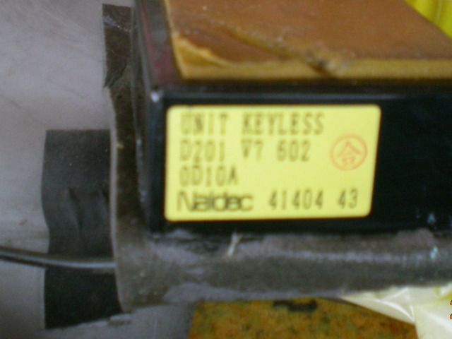

I decided to fit an after market remote central locking system, the same as I did on my previous bongo, so ordered my controller and fobs, and set about fitting the extra solenoid actuator that I already had , it was only after I had finished that an item that had been secured to the inside of the door panel with Velcro slipped down, and upon inspection found it to be a Japanese factory fitted key less entry controller, the aerial was taped along the door panel, well when I bought it there weren't any fobs with the van, I wonder if there's any way of obtaining fobs or if there's a self learning fob like the TV UNIVERSAL remotes, for it as it would be a far better system than the piggy back after market system.

From what I've been told, you have to buy the associated fob that goes with the actuator. Then it's a case of having that fob programmed by an auto locksmith. A quote I had from 'darn south' was a £100 and the cost of the Mazda fob at £30 second hand!!!

If you had a unit like this already floating about inside your drivers door, it would be reasonable to assume there is already a solenoid in the drivers door to lock/unlock by remote...? :idea: :arrow:

jaylee wrote:If you had a unit like this already floating about inside your drivers door, it would be reasonable to assume there is already a solenoid in the drivers door to lock/unlock by remote...? :idea: :arrow:
Yep and power! allowing an aftermarket setup to be installedin the door! unit has 4 wires, power is on blue and black, actuator control on red and green.

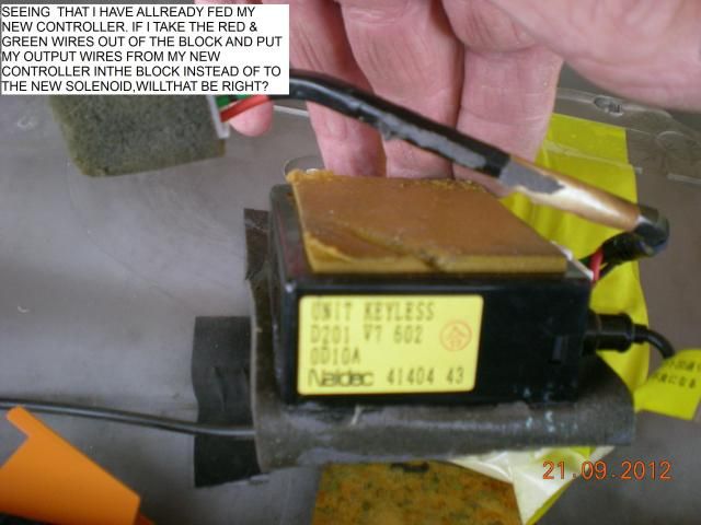

I will investigate further when I get a chance because it would be better if the original solenoid done the job via the new controller cheers

You could even cut off & use the the loom with the connector your holding, then splice onto the outputs of yer new controller module....? :idea: :arrow:

Post by Colin H F » Sat Sep 22, 2012 4:03 pm

No harm in trying.... :wink: Though there is a 50/50 the actuator may lock instead of open & visa versa...?!! But you can always swap the actuator pulse feed wires over..!

Done what I said I was going to do ,tried it out first and it worked perfectly so the old Naldec keless unit has been taken out along with the extra solenoid I put in, jobs a good un'
