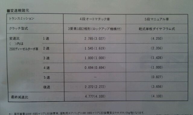

This may make more sense if you speak Japanese, but it shows the gear ratios of 4 speed auto and 5 speed manual 'boxes:
