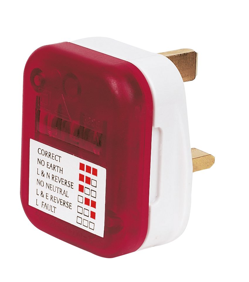

On the mains adaptor that Scanner advises..... get 2 and wire one in reverse.... also get a plug in mains tester like
 if it shows that the leccy isn't wired okay....check the lights on the plug......then use the reversed adaptor
Have a good holiday.....
