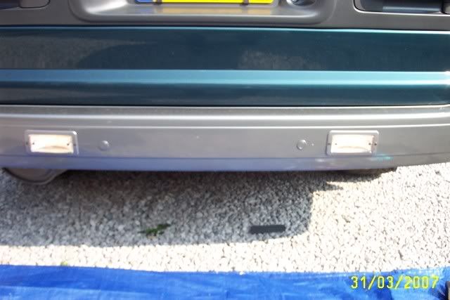

I enjoyed reading the old thread you linked to Mike :D Was that really 4 years ago?
Your flush rear fog conversion gave me the nerve to chop away at my rear bumper too! :lol:
The plastic is easy to nibble at... And easy to trim, you can only go wrong if you chop away to much! Remember... you can't put the plastic back on, so steady as you go with that stanley knife! :shock:
The pair of danglies the flush lights replaced...
With red bulbs fitted behind the clear lens versions...
And with clear bulbs.... :D

Is that right hand one wonky? ;)

lpgimports wrote:Is that right hand one wonky? ;)
Paul
Well spotted Paul! =D> =D> =D> It wasn't the day after (when i'd noticed it) #-o I just forgot to ammend the pictures :lol:
They're straight now! :oops: :wink:

Great stuff! Just another quick tip... Check for clearance of the bumper strengthening ribs before you mark/drill for the cutting... And you need the hole JUST big enough to squeeze the main body of the light through. If you cut the holes too big, you'll not have any material left on the bumper to screw the light surrounds onto... :wink:
I've seen some of this type of lamp protrude quite a way through the surrounds, making them not quite as flush as they can be... play around with the lights a bit to get the lens as flush with the surrounds as possible, then grub screw them in place (it'll be obvious when you have the lights laid out in front of you) :wink:
