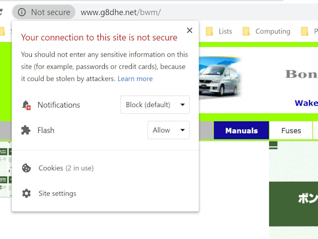

Same as ever but Chrome are dissuading people from using Flash by disabling it, you need to Right click the Warning message on the URL and then Allow Flash, then reload and it will remain enabled until Chrome is closed;
As far as I am aware other Browsers have not taken this approach ..... so FireFox etc. still work normally.
