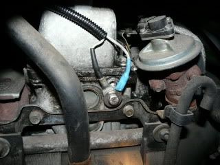

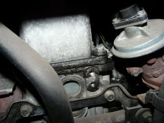

To date we have been advising a position for the Temp Alarm Sensors on the exaust side in one of the threaded holes in the cylinder head ...as below
Thanks to some feedback and my own observations whilst towing ...we are getting temps close to the max the alarms can regiester....125C
One of the forum members who has just fitted one has found a really good place to locate the sender and I have now moved mine to this new position...I would advise members to do the same....allow 30 mins and you need a 10mm & 13mm socket.....pull the carpet away from the rear of the engine cover and remove the metal inspection cover......right next to a core plug you will see 2 threaded holes...go for the bottom one....
this is very close to the coolant and well out of any airflow or other heat sources.

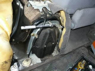

I have routed the cables around under the passenger seat well away from the exaust and anything else that could damage them. (you will only have one cable...the 2nd one in the photo is a new ESTC combo unit under test) (see web shop below for details)
You will find the gauge now reads quite a bit lower and be more consistant.
You may find you can locate the threaded hole and fit the sensor and bolt from under one of the seats and not need to remove the above mentioned inspection cover. Might be quicker even if a bit fiddley.
