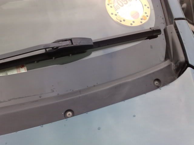

Post by meek.tv » Wed Sep 10, 2008 8:34 am
ok there is a fair bit of play. heres a couple of pics of how much i can move the wipers when parked up
is this a lot more than usual?
what do i do to remedy??

Posts: 15474
Re: floppy wipers
Post by Bob » Wed Sep 10, 2008 8:46 am
That does seem like alot of play to me, could be the mechanism needs replacing.
