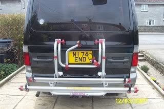

I fitted the Fiamma Pro C to our Bongo. Spoiler makes no differance as this model bolts stright onto tailgate. Very neat insallation. You may have to get your struts uprated to allow tailgate to stay open. This is no problem but does cost about £70 to get them regassed.

have a wee look in here..... (more photos) http://www.flickr.com/groups/bongoliers/ .... :lol:
