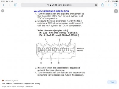

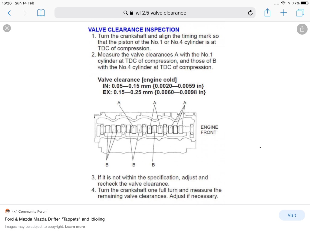

But trying to find the correct valve clearances is a bit out there 00.5 inlet 0.15 exhaust
They seem to vary were ever you look
Re: new member
This seems quite accurate
