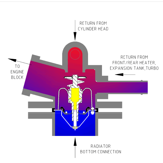

Re: Overheating - Looking for troubleshooting steps
That isn't what one would expect, the thermostat is at the "cold" input to the engine, once the coolant that is flowing back to the input side is above the thermostat temperature then the thermostat opens and allows additional cooled coolant in from the radiator to reduce the input temperature. Normally what happens when the engine overheats is it pushes coolant out of the engine into the de-gassing tank from which it then overflows/vents when the pressure rises. Best to refer to Steve Widdowson's diagrams and animations;

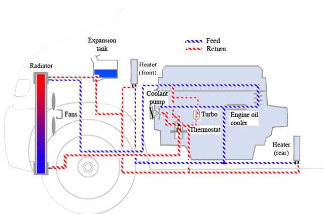

Thank you for all the replies :
g8dhe - thank you for the diagram, that is helpful
