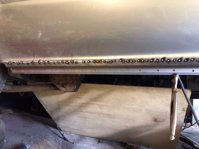

A few pics from the mission so far the wheel arches of course needed doing so working rearward along the Sills on driver side Cut the exterior arch metal back to new about 2 inches but had to carve masses of the inner arch away which is a complete bastard of a shape in out up down curving one way then another I had to put in 7 separate panels I’ll post that picture when I get my sanity back :shock:
Re: The Rust Directory
Posted: Mon Aug 03, 2020 8:39 pm
by willow2u
Could only do 3 at a time
