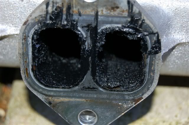

It's about time this thread received a pic of inlet manifold sludge, so voila!
Whilst replacing my cylinder head, I cleaned out my inlet manifold and disabled the EGR as follows:
1. Using Ian's bolt in the pipe approach.
2. Using the Russian method; although I blanked the end of the EGR pipe where it joins the inlet manifold union. I found that a 20 Euro cents coin which was rattling about in the footwell of the van was a perfect substitute for the 2 Roubles coin.
Interesting to note, that the guy who transferred the valves and camshaft from the old cracked head to the new one, found that the inlet valve integrity was dreadful and so replaced the inlet valves. Perhaps this is a result of all the sludge going into the head?
The van runs beautifully now, but because I've replaced so much it's impossible to attribute the improvement purely to the EGR disablement.

Jeeebus........I've never seen as much sludge as that in an inlet manifold :shock: :shock:
