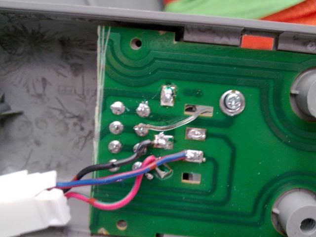

I actually repaired mine a couple of years ago Kirsty....
The solder that holds the clip/contacts for the florescent tube had gone here causing in-continuity & the lamp to flash.. Though yours are removed for the led's.

missfixit70 wrote:May be best to disconnect the centre light entirely, just undo the 3 screws under the plastic diffuser & there's a plug underneath, it's a complicated bit of kit in there :shock: I've cut out all that circuitry & fitted led strips inside instead. Should be less of a current draw then too.

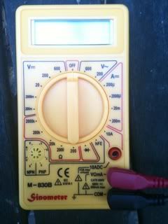

I've removed the central overhead light this evening to see if it is the cause of the drain.
I would much appreciate some instructions on what to do with my Multimeter. It's like this.
Image]
I'm afraid I need an idiots guide but it if helps to see what is taking the power load it will save a lot of time. Many thanks in anticipation.

Move the red lead to the 10adc socket & set the meter to the amps range where it says 10a. This meter is only rated at 10 amps so just be careful when you put it in place of the fuse in case your drain is higher. The meter will have a fuse in it so at worst it should just pop that it if the current is much higher, I suspect it will be below 10a though but that is just a hunch & I could be wrong on that. [-o<

OK thanks I'll give it a try. I guess I stick the pins either side of each fuse and if it says 0 there is no drain and if there is a reading to make a note of it and report back?
Alacrity
Posts: 634
Joined: Tue Jan 12, 2010 10:02 am
Location: Eastbourne, East Sussex
Re: Fuse 8 - Cigar lighters, Mirrors, radio - battery discha
Post by Alacrity » Tue Jun 28, 2011 8:47 pm
Yup, take the fuse out & attach the meter to the contacts where the two fuse blades push in (you may have to fiddle about & make something temporary up to attach the meter). The meter should be showing a reading if you have a drain, then disconnect stuff till you loose the drain. If it is showing 0 then there is no drain on that circuit but, if I remember correctly, the battery doesn't drain if you pull the fuse so it won't show 0.

Results for everything I believe to be running off the leisure battery :-
Fuse with radio, central locking, interior lights - 0.02 (turning on the central interior light took it to -0.67)
Fuse for exterior mirrors and 2x cigar lighters -0.00
Fuse for RH blinds - 0.00
Fuse for LH blinds - 0.00
Fuse for Zig unit leading to third cigar lighter, coolbox supply and water pump (all turned off) - 0.00
I did remove the wire leading to the 110v inverter box last Thursday and am now tempted to replace it and check the load with that connected just to see. It was connected to the fuse with the mirrors and 2x cigar lighters.
Is -0.02 an insignificant load?

That is insignificant (20mA) and probably just the backup current for the radio. Are you sure you have nothing else connected directly to the L/B itself ? Out mobile at present so may not be able to reply rapidly.
