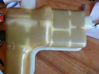

haydn callow wrote:Image
You will see 2 cracks on this tank......there is also a small partial crack......one of the 2 (on left) weeps under pressure.......none of these Bongos had LCA's fitted....that why the came to me ... to find a coolant loss and to have one fitted.
This tank was off a P reg and had signes of having overheated in the past....heavy staining
Ooh... the underneath of my tank doesn't look like that! Perhaps long term overheating bongo's with overly pressurised tanks go that way? The baffles look like they are straining to break through! At this early stage i'd suggest that normal none stained tanks may not suffer from cracks... Not if mine is anything to go by at least! (everybody breath a sigh of releif) AAHHhhh :wink:

5/6 out of 10 or so.....50% ..... 2 of which "weeped" I did see more in the early days of cutting them up etc and didn't really pay attention.....Only whe the first "weepy" one arrived did I sit up.
I will bring them to Stourport for anyone to examine.

Interesting.......Just examined the 3 tanks I have ......all have the 2 cracks in exactly the same position as in the 1st photo
1...just behind where the front mounting lug is.
2...just behind the larger rear most outlet pipe across the baffel.
One of the tanks is off a T reg V6....cracks but not right through..(not leaking)

Carn't find the post now ....in the last couple of days somone gave a link to a tank on sale on ebay......Guess what ???? had photos forwarded and the same cracks are there....I don't think I should post the photo's on here but I will send them to a email address if anyone wants to see them

haydn callow wrote: 1...just behind where the front mounting lug is.
Just taken a look at the tank I've been playing with. Got it from Mike at Wheelquick. It shows identical cracks to the one in Haydns pic. IDENTICAL. :shock: apart from the one I have isn't as clean.

And if memory serves me correctly Steve that tank is from a breaker with a cooked head. I wonder if the tanks with cracks have seen some "action"? Strange that it should only recently manifest itself... Stained? cracked? Correlation perhaps?

I don't belive it is a recent thing..just unobserved....how many peeps look at the bottom of a tank ??? I looked at at lot 3 years ago....never noticed them but I'm pretty sure they were there....Steve above didn't notice those untill he was prompted to look.

bigdaddycain wrote:And if memory serves me correctly Steve that tank is from a breaker with a cooked head. I wonder if the tanks with cracks have seen some Strange that it should only recently manifest itself... Stained? cracked? Correlation perhaps?
Not sure of its origin (except it came from Mike) ste. I was also wondering if the cracks may be associated with "action".

haydn callow wrote:I don't belive it is a recent thing..just unobserved....how many peeps look at the bottom of a tank ??? I looked at at lot 3 years ago....never noticed them but I'm pretty sure they were there....Steve above didn't notice those untill he was prompted to look.
That's a releif... If you've only had one that is actually leaking through the many tanks you've had pass through your hands, then it would appear as if the cracks could well be visual fissions that may never develop into a leak.
Bongo tanks seem to be a little "two a penny" these days, should mine develop a leak via a crack, i'm pretty sure i'll be able to get hold of another crack free example. :wink:

Iv'e had two that actually "weep" under pressure as said above.
