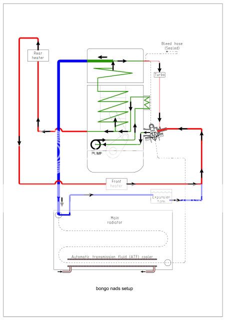

Hi John (bongo nads)
I know you said earlier that you are (quote) 'a sensitive little cherub' but you need to calm down a bit. No one is looking to rubish your ideas - No one at all. In fact, personally I thought your method of bleeding made absolute sense. My problem with bleeding, and I suspect quite a few others are in the same boat, is that I would not have the confidence to do it myself, and we have to rely on others. From what I gather, there is more than one way to do it. The current Forum standard procedure is not the same as yours, Mike Goughs, or even the Mazda manual, but it works. They ALL seem to work.
The bottom line of what I am trying to say is don't be put off from sharing your ideas cos I'm sure we can all benefit from your experiences. That's why I come on this forum - to learn.

Post by widdowson2008 » Wed Jun 23, 2010 1:19 pm
Bongo nads wrote:
But my solution was to line the heaters up in series instead of in parallel. So the water out of the driver side block goes down to what was a T, but now isn't a T, but instead ALL the coolant turns right to the rear heater, does its thing there then heads back past what was the same T, to pick up again where the T had been and on to the front heater.
No figure-8, just one big loop with two heaters in it, followed by a bleed hose, and then the return to the thermostat as now, that other T on the passenger side being blanked off to the rear as per the Fury version. Both heaters working admirably, faultlessly, and never an airlock (says he tempting the very Devil himself).
Did someone beat me to this?
Something like this?
Steve

Post by widdowson2008 » Wed Jun 23, 2010 2:32 pm
Bongo nads wrote:You cannot have just drawn that in the last few minutes, but it has my nickname on it. It must have already been somewhere on the site. Yes?
Got you thinking there didn't I? Could have spun you a load of crap and said 'yea - it's been done before - just added your name to it' :wink: ...................but in truth........
I created the diagram sometime ago and updated it as I learned more about the system. I just had 10 minutes work to do to create your system from the original. It came from this one.........Image
But you didn't answer the question. Is it correct?
Steve

Post by widdowson2008 » Thu Jun 24, 2010 7:10 am
Well spotted - I missed that one :oops:
Getting back on thread, does anyone know if has mrdeano won his battle?

mrdeano
Thank gawd, Bertie Bongo has been bled
Post by mrdeano » Sun Jul 04, 2010 1:07 am
Well all good the results are good, after finally getting me mate to help me bleed Bertie last Sunday, I did a quick trip to Reefton our nearest town which is 70 km's return and sorted out the water level which needed a quick top up. I've done a few trips between home and Westport, that's a 100 km return through the Lower Buller Gorge and all good so far, so last Thursday I ventured over to Christchurch, two mountain passes, one 720 metres above sea level and the other 940 metres ASL plus return, and Bertie Bongo didn't use a drop of water let alone any oil so I am pretty damn happy with the end result of the bleeding.
Both heaters work absolutely fine, keep me lovely and warm as it was about 2 degrees over the mountain passes.
I arrived home from Christchurch on the Friday so am quite pleased with the Bongo now.
Thank you very much everyone especially ADY for your wonderful advise, but now I can add my two cents worth and say, just add a bleeding hose into the Bongo, I'll ask Steve to add the pic and mum's the word.
Cheers and Thank you.
