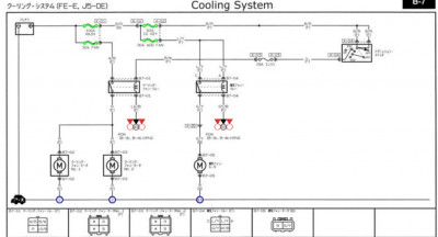

Sorry to re-open this thread.I would welcome some advice on how to track down a problem with my Y plate 2L petrol bongo with digital AC.
Driving in traffic last weekend (Mid March and chilly) and noticed the temp gauge climbing. Usually it stays firmly resting on the left hand end stop unless working hard in warm weather. Turns out the radiator fans have stopped coming on. I have been through the forum for hints and tips and done the following.
1. Turned AC on and off. No change.
2. Manually turned the fans and then applied 12v. They are free and run on a direct supply.
3. Tested all the fuses in the drivers box and the one in the middle under the bonnet. All fine.
4. Pulled the relays and tested that they click with power, they do. (the four in front of the car bat, the two in the engine bay fuse box and the front two on the passenger side wing.)
Its in for its MOT today and they mechanic will make sure the AC is gassed and look to try re-gassing if needed.
The next step is to swap over the relays in front of the bat and see if they move the problem.
Questions.
Can anyone give tell me which relays are for the fan? I can't find a diagram.
Any other diagnostics tests?
I can see a data port under the glove compartment. Is this useable?
Any suggestions or pointers would be much appreciated.
Many thanks, David
Posts: 10971
Re: Radiator fans not working
Post by g8dhe » Tue Mar 28, 2023 11:04 am

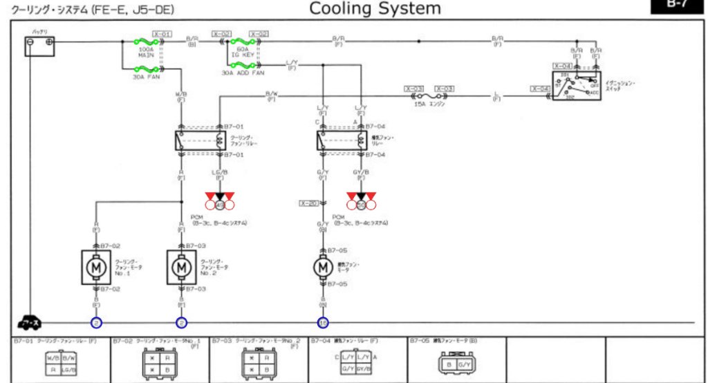

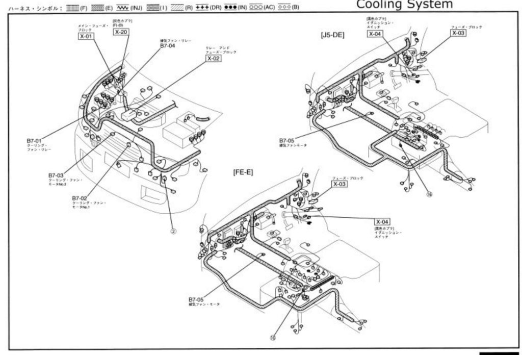

The diagrams for the fan circuits are below followed by the locations;
The wiring diagrams are still on line here http://www.g8dhe.net/bwm/ but you need a browser that can handle the old Adobe Flash system
The only browser that can still handle the files is the Chinese based one that was allowed by Adobe to continue using the Flash system which can be downloaded here https://pdds-cdn.ucweb.com/8-0/UCBrowse ... 10215).exe
They go to great lengths to try to get you to download various other versions, which don't still support Flash, I have given you a link to the exact spot I downloaded but watch out for spurious links to other types of UC Browser! It works fine but I can't say what else might be built in so use at your own risk 😉

Thanks for the diagrams. Really helpful. I think the issue is the emu not sending a switch on signal to the relay. Since the AC does have gas pressure and the temp gauge is registering. I think the issue may be the emu itself.
Posts: 10971
Post by g8dhe » Wed Mar 29, 2023 11:26 am
Check to see if the coolant temperature sensors are OK before suspecting the ECU itself.
David41r
Posts: 3
Joined: Thu Mar 23, 2023 4:11 pm
Location: Sussex
Post by David41r » Fri Mar 31, 2023 12:45 pm
Thanks for the suggestion.The coolant temp sensor does appear to be working. It has an impedance and when i touch a 4.5v battery across the terminals the engine note rises but the fan does not come on. (also reversed polarity and the engine note dropped.)
So my thinking is.
The circuit to power the fans is fine - fuses good and relays ok.
The sensors to the EMU are good and the EMU is responding to the inputs in some way.
The signal to switch on the fans is not getting to the relay.
So either a bad connection between the EMU and the relay or a bad component in the EMU output stage. Had a poke around in the EMU wiring, looks in good order and not for the faint hearted. I have ordered the wiring manuals CD and will try to find the control output pin to test the continuity from the fan control output.
