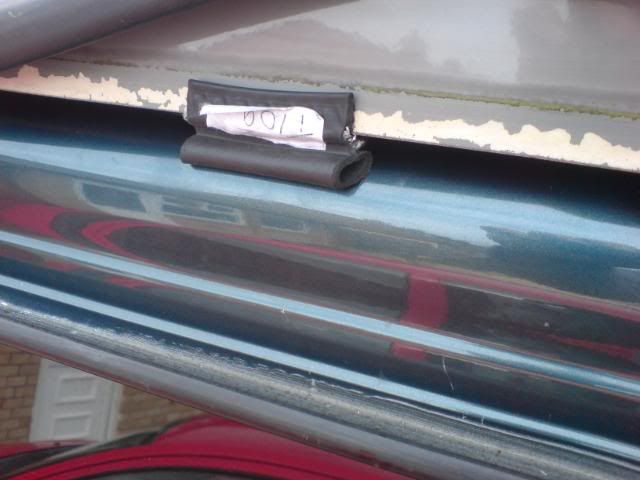

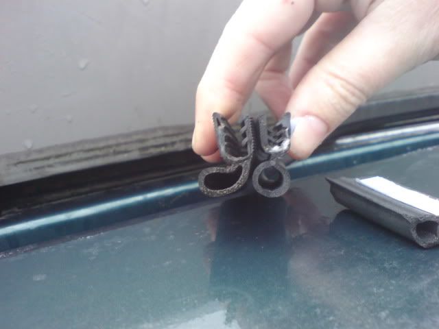

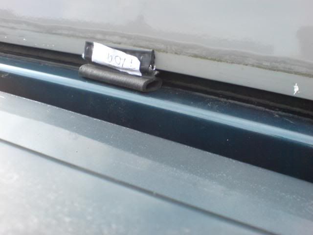

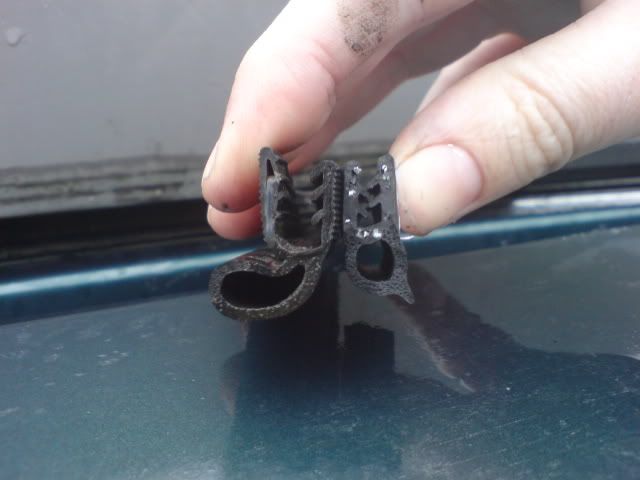

Got a couple of samples today from the Rubber Trim guys,
This one is T110
This is T109
The seal itself looks like it'll do the job on both (if you check the dimensions of the actual seal bits), but the bit that grips onto the AFT isn't quite so tall, it looks like it'll grip on ok, but you'll possibly be left with a grubby line (which may Tcut off?) Don't know what prices 'll be yet.

It looks like t110 might be best but the piping is not as big but then the original might be a bit swollen. I will see how you get on and if its no go I can contact wheel quick and see if they have a supplier if you like. Hope all goes well.Thanks for the information [-o<

Don't think the original is swollen, it's just different. The main difference is the size of the bit that grips onto the AFT.

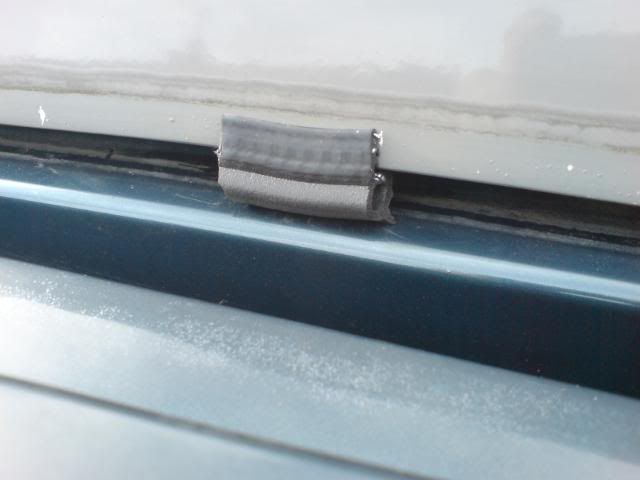

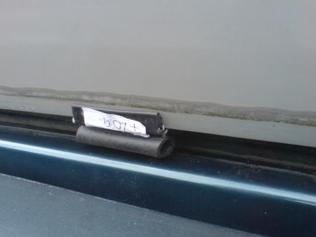

Post by missfixit70 » Mon Mar 29, 2010 12:03 am
T109 in situ
rear, roof up
rear roof down
side, roof down

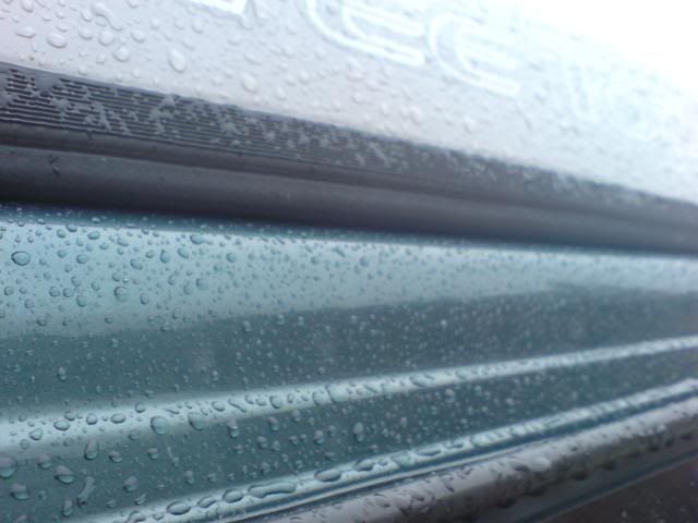

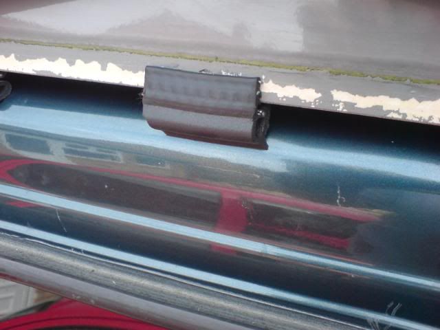

T110 in situ
rear, roof up
rear, roof down
side, roof down

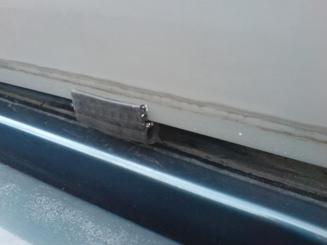

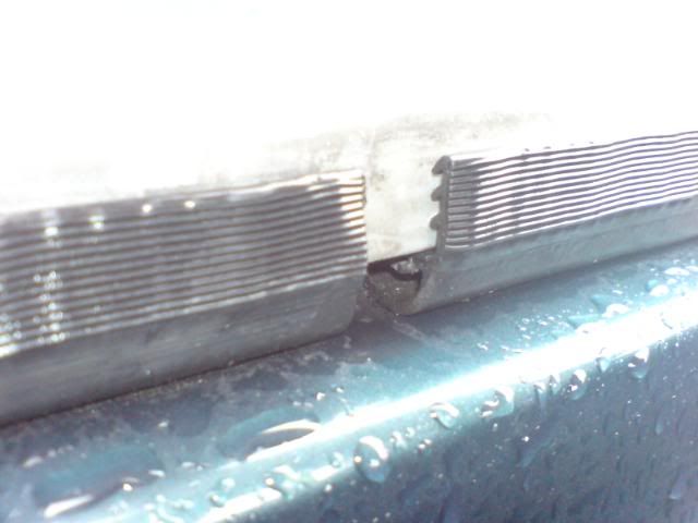

Neither of them made a very positive seal, especially T110,
As you can see compared to the original
The fact that the original is skewed to one side is what makes it seal properly, especially on the sides.
The search goes on?

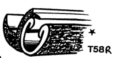

This company http://www.rubbertrim.co.uk/ Edgware Motor rubber & trim do a good selection and the
T58R on the wall chart;
or the T109;
look possibilities but whilst the wall chart says the images are full size I think I would want a sample to try first!
Actually these look similar especially the T109 to what Kirsty tried but maybe this company will be more cooperative ?
